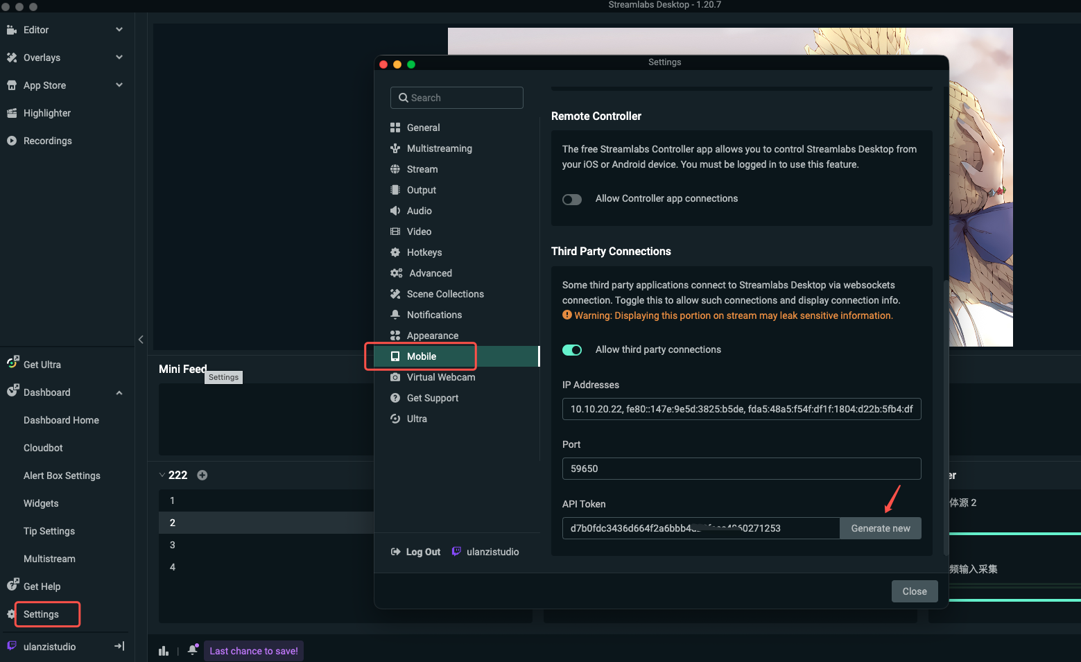

Hello, please provide the following basic information:
1. Device model
2. Computer operating system version
3. Ulanzi Studio software version
Please check the API token. You can try using a different one and entering it into the plugin. We’ve verified that the switch works normally, so we need to identify the specific step where the issue occurs.
