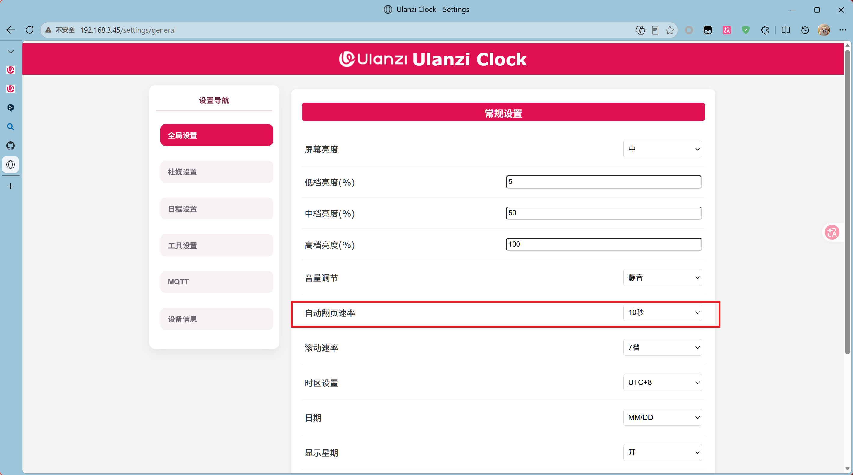

Would it be possible to add Automatic transition between pages - basically automatic cycling through all active pages, while keeping each page displayed for a chosen period of time? Such feature exists in awtrix firmware which I already use on TC001. It would be nice if type of transition effect between pages and it's speed can be selected as well.

use web control,URL is your device IP ADDRESS.

I already tried that, but that doesn't work. Are you sure it's for transitions between different pages? I think that's just for transitions within one page, for example weather page where there are automatic transitions between different informations. If I set page to clock nothing happens, even with that setting set to 10 seconds it always stays on clock page and never change to other pages automatically.

You need to press the orange knob at the top once. Four dots will then appear on the right side of the screen (see attached image), and this is when automatic page turning will activate. If the four dots do not appear, the screen is locked to a single app and will not turn pages automatically.

Oh, I see. It works now. Thanks for info! That wasn't explained anywhere
