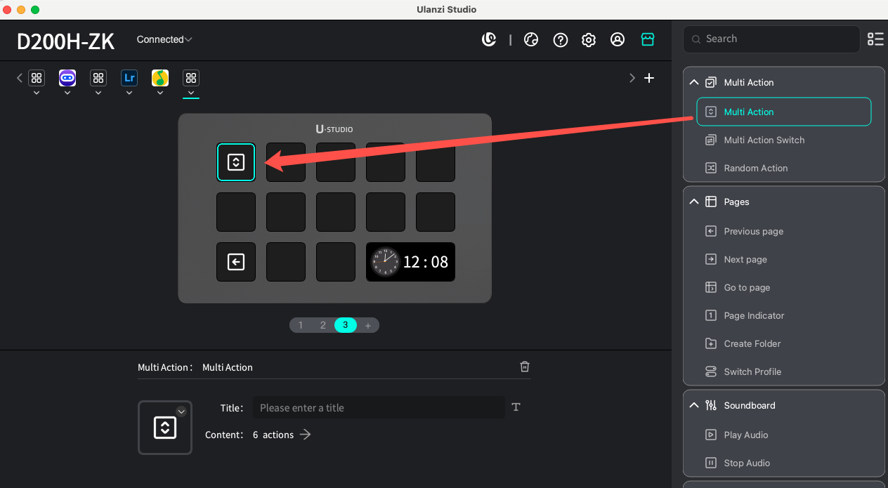

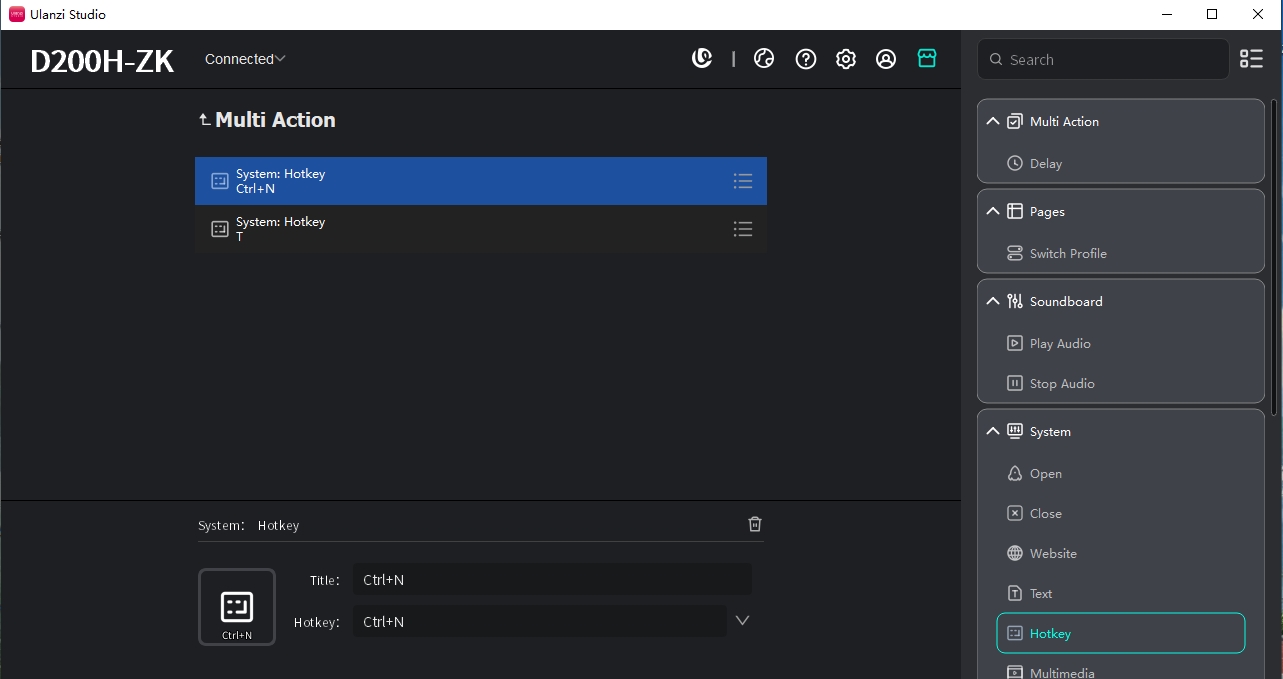

Hello, using Ctrl plus two letters as a shortcut in the Hong Keyboard app is an unconventional combination, and current shortcuts have limitations.
You can try using the “Multi-Action” feature, as shown in the image below. Without setting a delay, this allows for a shorter interval between the two actions. See if this meets your needs.
