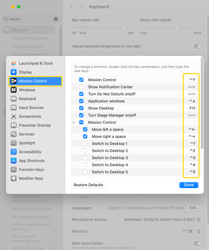

This limitation seems to be affecting the Mission Control & Spaces. I thought its the Control key but it's not.
Setting up the shortcut in macos system settings for example to the "show spotlight search" to Ctrl+S and than setting the same shortcut in Ulanzi Studio works.
But if i add Ctrl+→ which pressed on keyboard switches to the next space in mission control this does not work in Ulanzi Studio. Pressing this key on the deck functions as the right arrow alone ignoring the control
If you could solve that in update it would be super helpfull.
Additionally ability to add the "globe" button as a shortcut (starts dictation in macos).
发表于 2026-2-3 18:53:02 | 显示全部楼层
After additional investigation: no matter what shortcut combination i set up for Mission Control it it does not work in Ulanzi.
As a temporary workaround I managed to run the mission control shortcuts via app made in Automator, but it's not ideal - there is a significant delay running the app that invokes the shortcut vs pressing it on a physical keyboard. The faster workaround was launching Apple Script with Scripts app, but it resulted in privilages error (scripts are not allowed to invoke keystrokes).
The Automator app setup does only 1 thing which is "Run AppleScript":
  1. on run {input, parameters}
  2.                 tell application "System Events"
  3.                            key code 126 using control down
  4.                 end tell
  5.         return input
  6. end run
However: the apple script proves it should be possible to add this to Ulanzi Studio. Maybe this will help with development.
