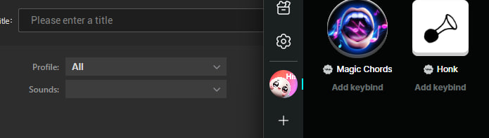

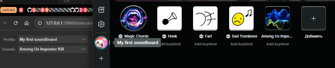

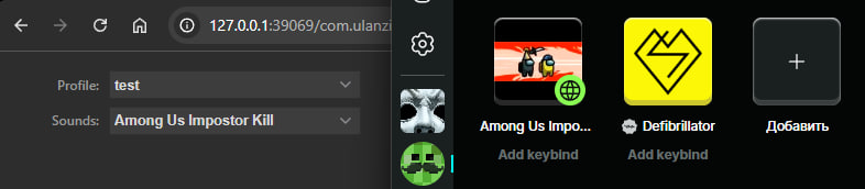

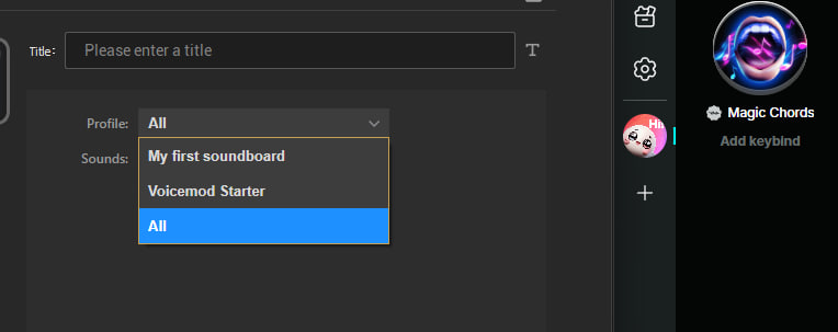

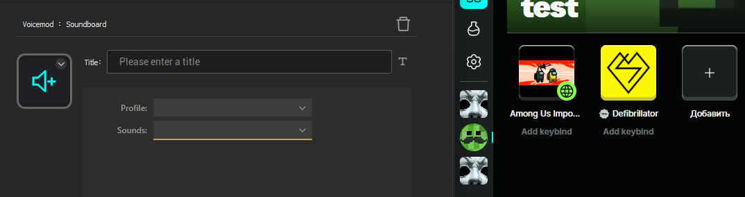

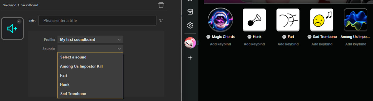

Hi. It seems that the plugin for working with Voicemod is broken - I have a Pro license for Voicemod and the plugin does not load my profiles and sounds when adding the "Soundboard" button on the deck.
If I log out of my Pro account and log into a new free account, the sounds are downloaded and displayed in the list.
Moreover, everything works fine in the UlanziDeckSimulator.
There is a suspicion that the Ulanzi Studio application cannot process the huge flow of information from Voicemod (if you buy a Pro subscription, a huge number of voices and sounds are unlocked for you) and at the moment the plugin does not have time to process such a huge amount of information, but this is not accurate.
Screenshots are attached below:
1. Free Acc Simulator - A general screenshot of the list of sounds from the simulator, when logging into a free account in VoiceMod (there are lists)
2. Free Acc App1 - A general screenshot of the list of sounds from the Ulanzi Studio program, when logging into a free account in VoiceMod (there are lists)
3. Free Acc App2 - Screenshot of the profile list from the Ulanzi Studio program, when logging into a free account in VoiceMod (there are lists)
4. Free Acc App3 - Screenshot of the list of sounds from the Ulanzi Studio program, when logging into a free account in VoiceMod (there are lists)
5. Pro Acc Simulator - A general screenshot of the list of sounds from the simulator, when logging into a PRO account in VoiceMod (there are lists)
6. Pro Acc App1 - Screenshot of the profile list from the Ulanzi Studio program, when logging into the PRO account in VoiceMod (the lists are empty)
7. Pro Acc App2 - Screenshot of the list of sounds from the Ulanzi Studio program, when logging into the PRO account in VoiceMod (the lists are empty)
P.S. Exactly the same problem appears when adding the "Voice Changer" button on the deck - the list for selecting voices is also loaded in the simulator, but not in the Ulanzi Studio application.
P.P.S. Both the Ulanzi Studio application and the Voicemod application were reinstalled several times, different combinations and launch queues were tried - the lists are not loaded from the PRO account, period. Although the rest of the switch functions (for example, "Mute Mic", "Hear Myself" work great).

发表于 2025-11-9 12:48:32 | 显示全部楼层
SGNLawlor 发表于 2025-11-8 05:28
Yall posted this begining of October. Yet it is apperant that nothing was fixed as I am still havi ...
Hello, the cause of the problem is already known. We are just scheduling the development and plan to release it within this month.

发表于 2025-11-17 17:31:10 | 显示全部楼层
I have a VoiceMod Pro account, and the sound data for the voice board feature is indeed quite large. When initially dragging the voice board into the interface, it takes a considerable amount of time to load—possibly over 10 minutes. At first, I thought something was wrong, so I restarted the program once. After everything finished loading, it finally displayed properly. You might want to wait a bit and give it a try.
