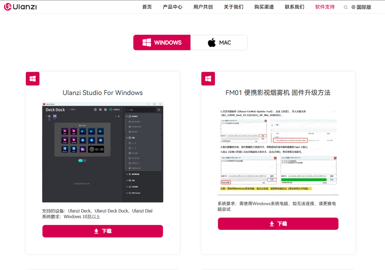

  1. 安装Ulanzi Studio
  • 访问官网下载并安装UlanziStudio软件。

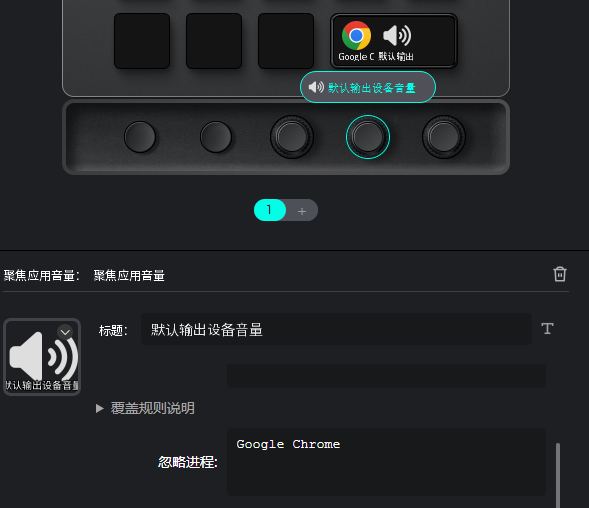

三、功能展示将功能拖入旋钮,聚焦当前的应用,若支持调节音量会显示应用图标。若不支持则展示备用方式。如图,当聚焦 Google Chrome  时,未设定忽略进程的第一个旋钮显示当前图标。第二个旋钮中设定了忽略进程,则显示了选中的备用方式。

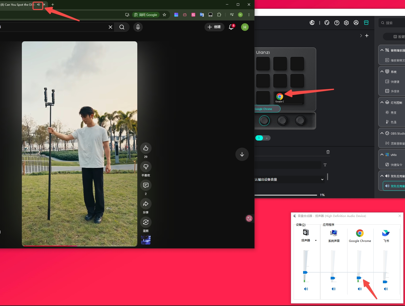

Thanks for your feedback!
I tested it with the version from the store, and when the Chrome window is selected, Ulanzi is able to display the app icon normally.
Regarding the volume knob, Chrome’s volume control only takes effect when there is an active audio source in the browser, such as music or a video playing. To check whether the knob is working properly, you can open the Windows Volume Mixer and watch the app’s volume level while turning the knob.

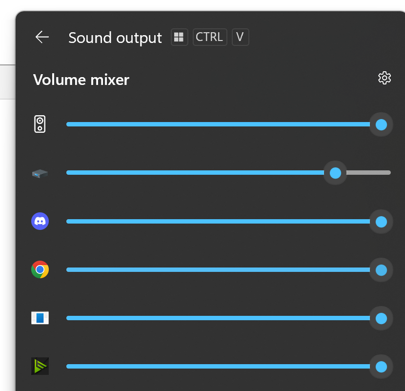

I am wondering how i can get this to control my volume mixer, specifically a knob to control my capture card, another to control Google Chrome, and the last knob to control Discord? I am able to get the application to adjust it, but then it switches back, like if im on Discord, it'll control that volume but then if i go off and go to google, it'll switch to control Google, I don't see a way just to control specific ones the entire time.

stormtucker25 发表于 2026-6-29 04:35
I am wondering how i can get this to control my volume mixer, specifically a knob to control my capt ...
you can't with this plugin. this is only to control what app is focused on windows . you need a separate app for that
