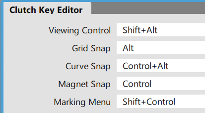

These are they keystrokes I'm trying to emulate.
View Control = Shift+Alt
Marking menu = Shift+Ctrl
If I make one button "Shift" and the other button "Alt", I cannot activate the view control.
If I make one button "Shift" and the other button "Ctrl", I cannot activate the Marking Menus.
It does not seem possible to apply the hotkeys Ctrl, shift & Alt together , byt themselves?

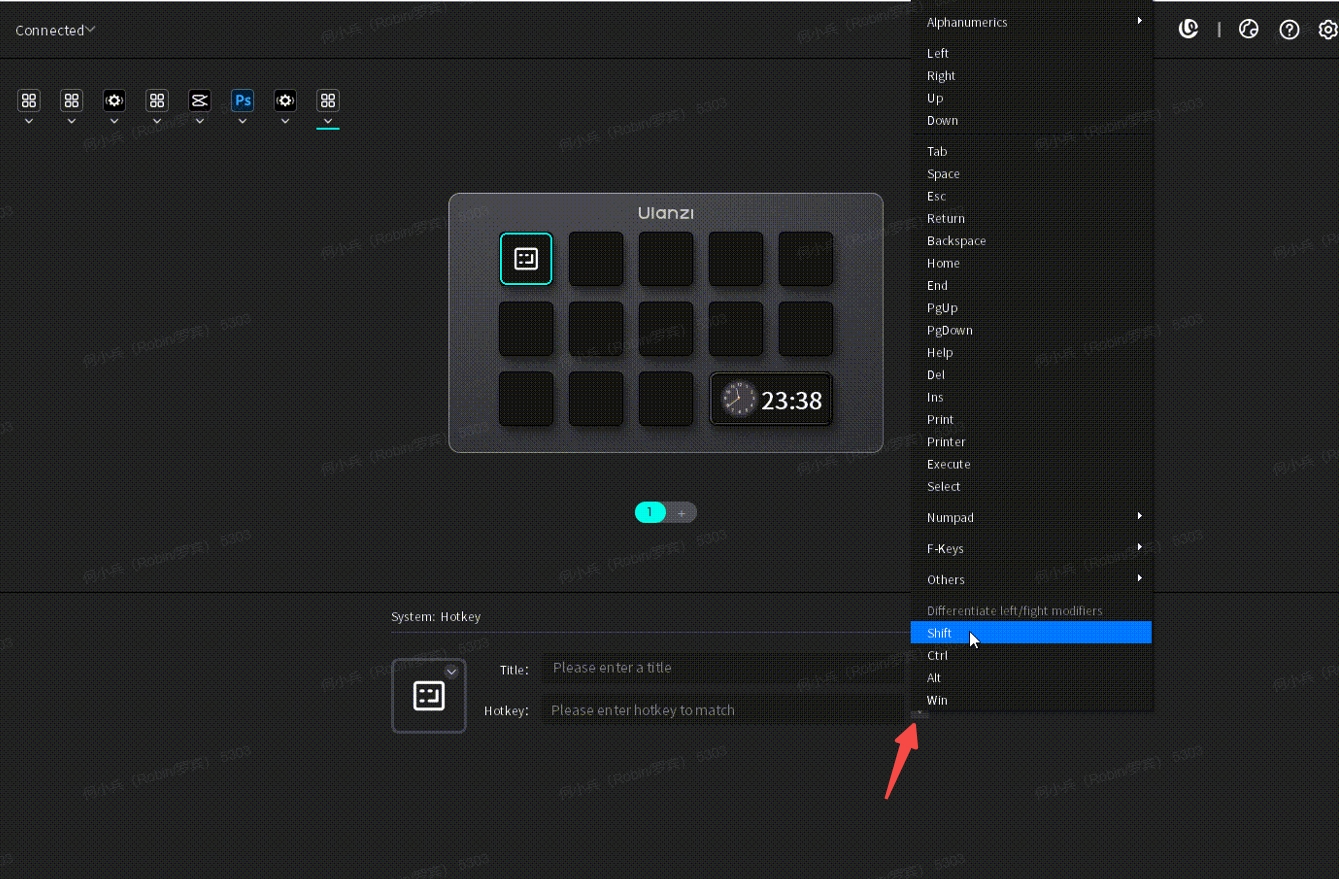

发表于 2026-4-12 23:41:24 | 显示全部楼层
Hello, the individual modifier keys can be set through the APP, and they can also be combined with other characters.
