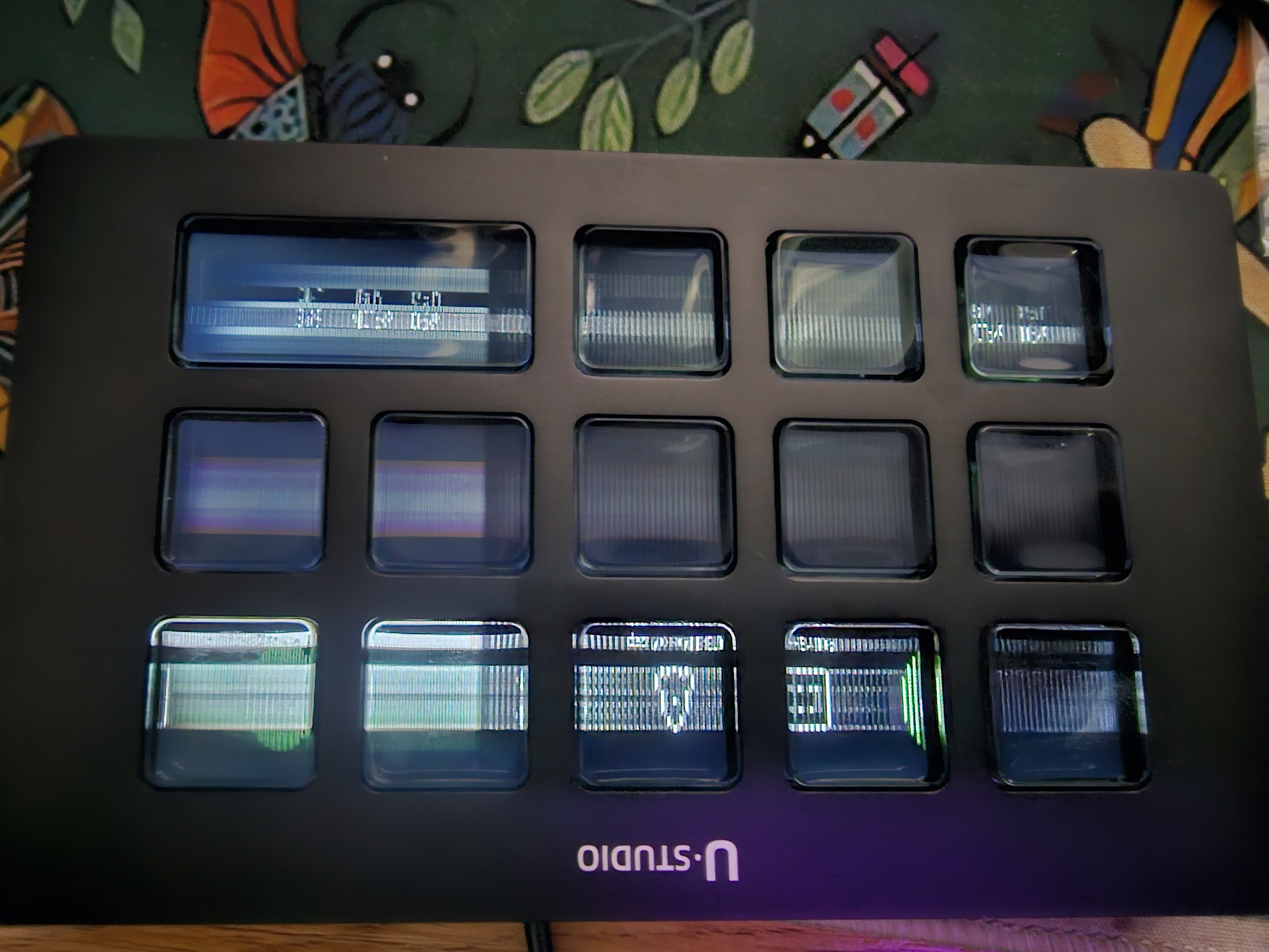

发表于 2026-5-3 12:32:52 | 显示全部楼层 |阅读模式
I updated the firmware on my Ulanzi D200 following the instructions in your guide.
After the update, the screen stays glitched. I am attaching an image showing the issue. 1000232311.jpg
发表于 2026-5-3 18:19:24 | 显示全部楼层
Based on your description, it seems that the firmware version was mistakenly installed. Please carefully review the precautions.
Please use the RK firmware upgrade tool to update the firmware. (Only compatible with Windows)
Video tutorial link:
https://cdn.ulanzistudio.com/sharing/D200%20RK%20Flash%20for%20Windows.mp4
The attached tools in the download link:
https://cdn.ulanzistudio.com/sharing/Starting-up_update_2601.zip
Notes:
1. The compressed file in the link contains the Word tutorial and important precautions - please read them carefully. There are two IMG files in the folder. Please upgrade the RK firmware after exiting the Ulanzi Studio App.
2. The forceps used for short-circuiting must be conductive. First, touch the two contacts with the forceps, then insert the USB cable. Please follow this sequence strictly and check if the RK App detects the new device before proceeding to the next step.
3. If the screen displays a blank screen after flashing the 2.0.3 version IMG file, please replace it with the 1.7.4 version IMG file. Then install the 2.0.19 application version to push the update to 2.0.3. [The download link for 2.0.19 is provided in the Word document later.]
4. After upgrading the firmware application version to 2.0.3, you can update the Ulanzi Studio app to the latest version.

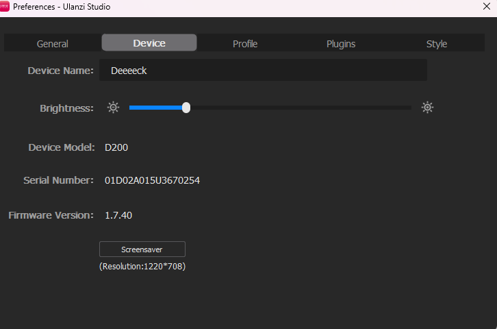

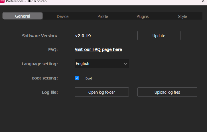

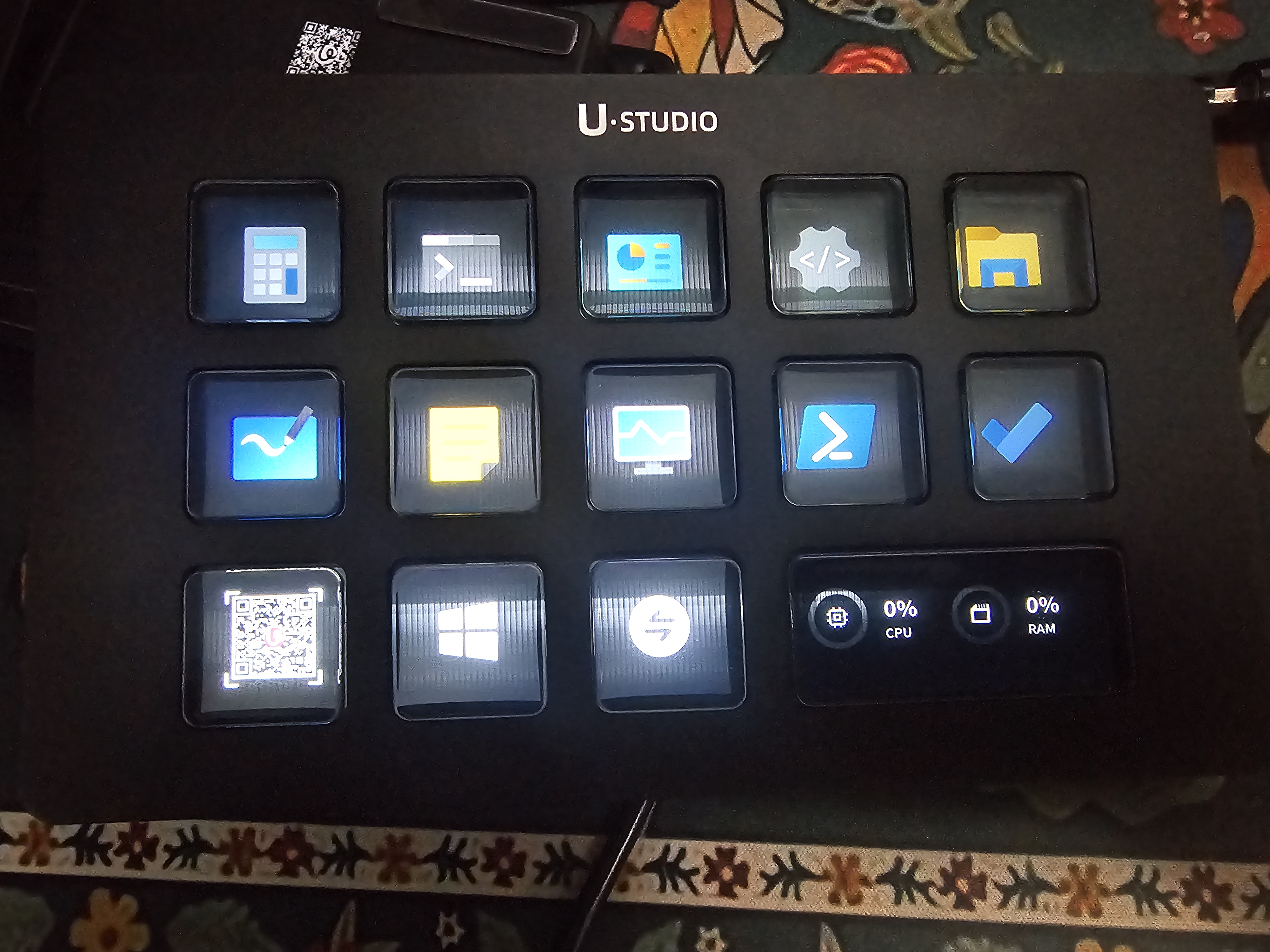

 楼主| 发表于 2026-5-4 06:44:22 | 显示全部楼层
Thank you for your reply.
I followed the instructions you sent and completed the firmware update process, but the issue is still not resolved.
Serial number: 01d02a0
Current behavior:
With firmware 2.0.3, Ulanzi Studio detects the device and buttons/profiles update correctly, but the screen shows constant glitch lines from startup.
With firmware 1.7.40, the screen distortion is reduced, but lines are still visible from startup and button updates do not work correctly.
I am attaching photos [img][/img]showing the screen issue and the current behavior of the device.
Could you please review the attached files and advise whether there is another firmware version or a specific firmware for this device batch?

发表于 2026-5-5 17:32:06 | 显示全部楼层
Hello, please contact the customer service of the purchasing platform's store to synchronize the relevant information. The customer service will provide you with after-sales service. Thank you.
