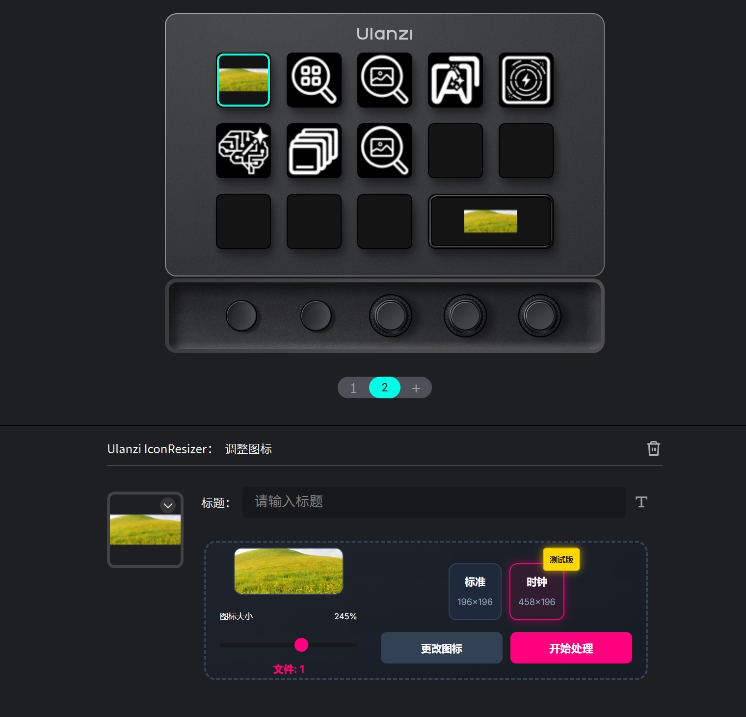

  1. # Ulanzi IconResizer
  2. O **Ulanzi IconResizer** é um estúdio de customização completo e automatizado para o **Ulanzi Deck**. Ele permite criar, redimensionar e otimizar ícones de altíssima qualidade diretamente na interface do seu Ulanzi Studio, sem necessidade de softwares externos.
  3. O plugin conta com suporte total ao formato **Padrão (196x196)** e ao formato widescreen exclusivo do **Relógio (458x196)**.

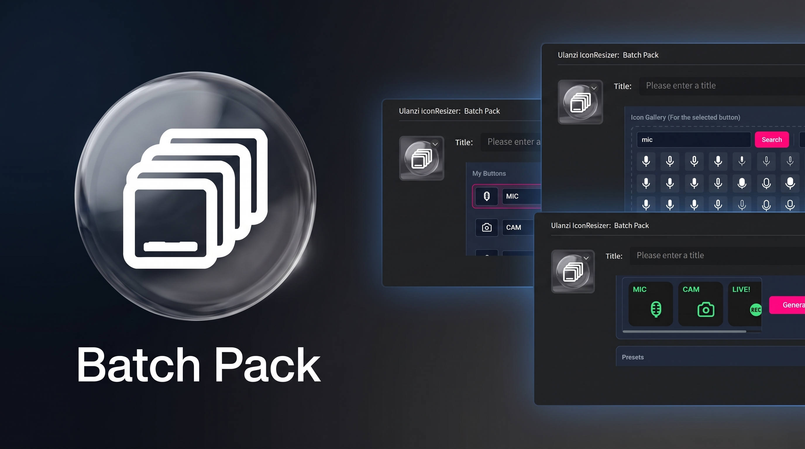

  29. - Suporte a 7 efeitos premium nativos: **Pulse, Spin, Marquee, Blink, Rainbow, Shake e Bounce**.
  30. - Possibilidade de ajustar a velocidade de reprodução para cada animação.
  31. ### 6. AI Generator (Inteligência Artificial)
  32. Uma experiência de criação imersiva assistida por IA.
  33. - Painel conversacional interativo para guiar a criação do seu ícone de acordo com o botão escolhido (Padrão ou Relógio).

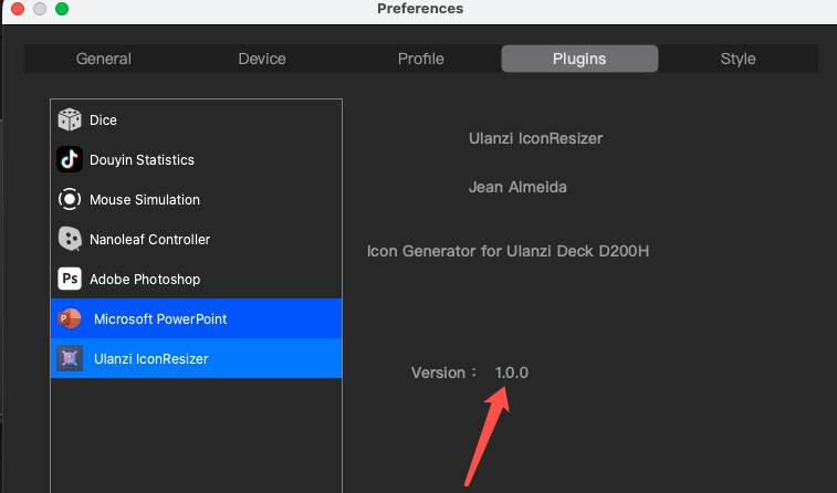

发表于 2026-6-3 17:22:21 | 显示全部楼层
darkdomi 发表于 2026-6-2 11:13
Sorry for the delay in responding, I received the feedback and corrected the error, and I've impleme ...
Hello, I’ve tested the new version, and the features are powerful and impressive.
Please note the following points:
1. If a new version is released, such as V1.0.2, the version number within the plugin must also be updated. The version number should be incremented with each change so that the app store can detect the update and provide notifications.
2. Once the features are stable, please evaluate whether Mac support is feasible. We’ve conducted preliminary testing on Mac, and basic operations work normally, though the generated images are not being saved.

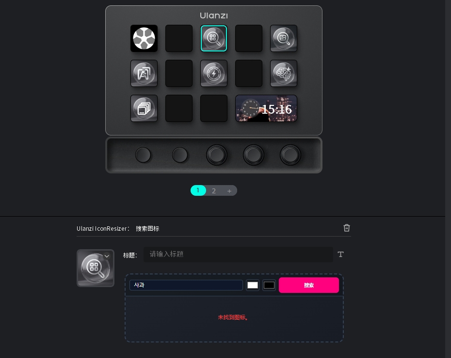

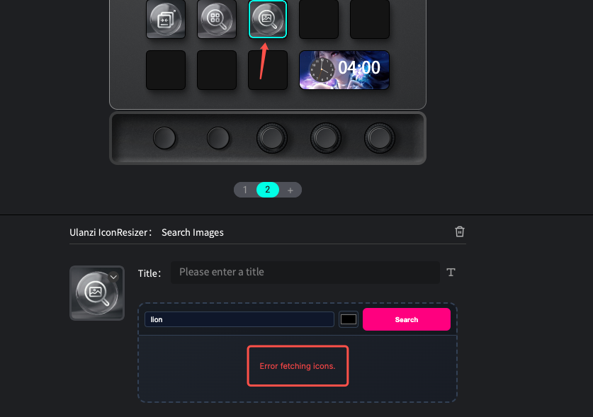

发表于 2026-6-4 16:40:31 | 显示全部楼层
We’ve conducted smoke testing on version V1.0.3, and it works perfectly with Mac OS. We’re blown away by the new features—they’re amazing.
We’ve identified a few usability issues that we can address in future updates.
1. Regarding the “Resizer Icons” feature, we found that on one Windows laptop with a 4K resolution, the preview appeared normal when creating a Clock icon, but the actual saved image did not fill the button. On other computers with 1080p screens, it worked normally.
2. “Search Icon ” Feature
Search results vary by language. For example, searching for “Apple” in English returns results, but searching for “사과” in Korean yields no results.

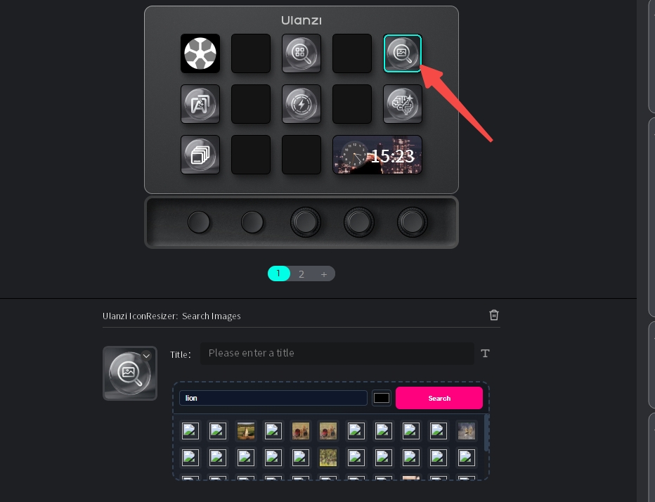

3. “Search Image ” Feature
3.1 When searching for “lion” online within mainland China, images do not appear in the search results, but “Search Icon ” works normally.
3.2 In the global network environment, some thumbnails in the search results appear abnormal, whereas those in “Search Icon” display normally.

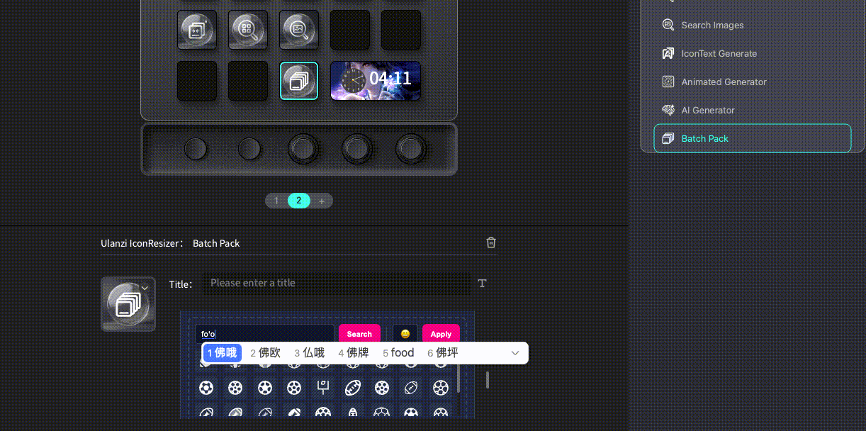

4. The “Batch Pack” feature returns no results for the Chinese term “足球,” but does return results for the English term “football.”

 楼主| 发表于 2026-6-6 04:56:45 | 显示全部楼层
Ulanzi 发表于 2026-6-4 16:40
We’ve conducted smoke testing on version V1.0.3, and it works perfectly with Mac OS. We’re  ...
Obrigado pelo feedback, irei fazer os ajustes nescessários, e estarei postando a atualização.

 楼主| 发表于 2026-6-7 10:53:12 | 显示全部楼层
Olá, equipe Ulanzi,
Obrigado pelo retorno detalhado. Resolvi todos os pontos levantados, além de uma rodada de melhorias e adequação. A versão 1.0.4 está finalizada, testada e pronta para publicação.
Repositório: https://github.com/JEAN-ALMEIDA-CZO/Ulanzi-IconResizer-Plugin
Problemas que vocês reportaram — corrigidos:
Busca não retornava resultados para termos fora do inglês (ex.: "football" em chinês): agora toda busca traduz automaticamente o termo para inglês antes de consultar a API. Funciona em Search Icons, Search Images, Batch Pack e no Image Bank da IA — qualquer idioma digitado → resultados corretos. Entrada em inglês é preservada.
Search Images quebrada / miniaturas anormais na China continental: as miniaturas e os downloads agora passam por um proxy global de imagens (com fallback direto), então os resultados carregam de forma confiável na China, Coreia e outras redes restritas. Search Icons continua funcionando normalmente.
Notebook Windows 4K — Resizer Icons / Clock não preenchia o botão: o pipeline de exportação foi reconstruído para ser independente de DPI (baseado no retângulo real do quadro do cropper renderizado). Os ícones salvos agora preenchem o botão corretamente em 1080p e 4K.

Os 9 arquivos de idioma e o manifest foram validados.
O plugin está com a Versão 1.0.4 no manifest e pronto para a atualização no Marketplace quando vocês quiserem.
Qualquer coisa fico a disposição! Muito Obrigado.
