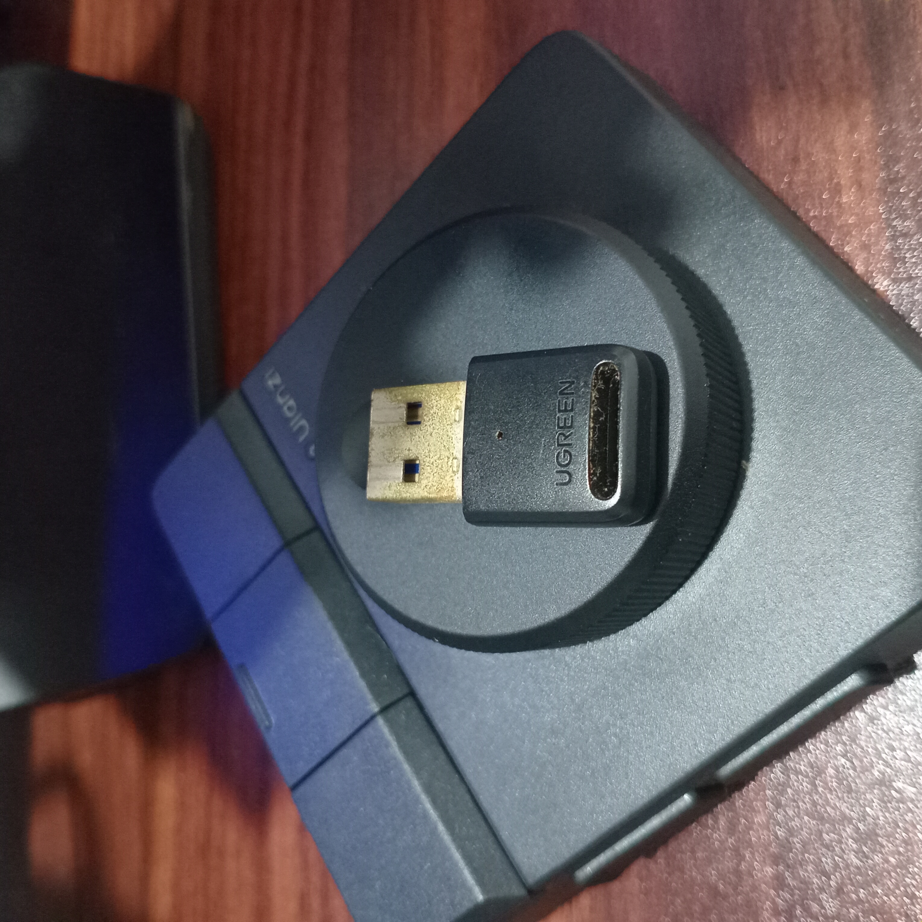

Hello Im Using External USB Bluetooth Dongle Ugreen 5.3 as you can see on the picture, is there another workaround fix ?

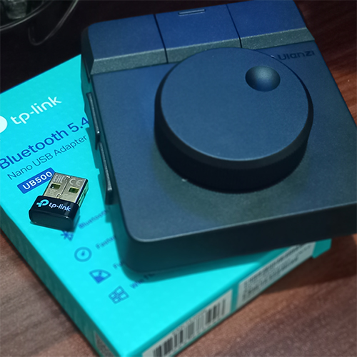

I solve problem Now It Automatically Reconnect When I Restart / Turn On My PC
I bought new bluetooth device 5.4 ( Tp-Link UB500 ) which has Installation Driver on Website , the Ugreen Previously has only Generic Driver
