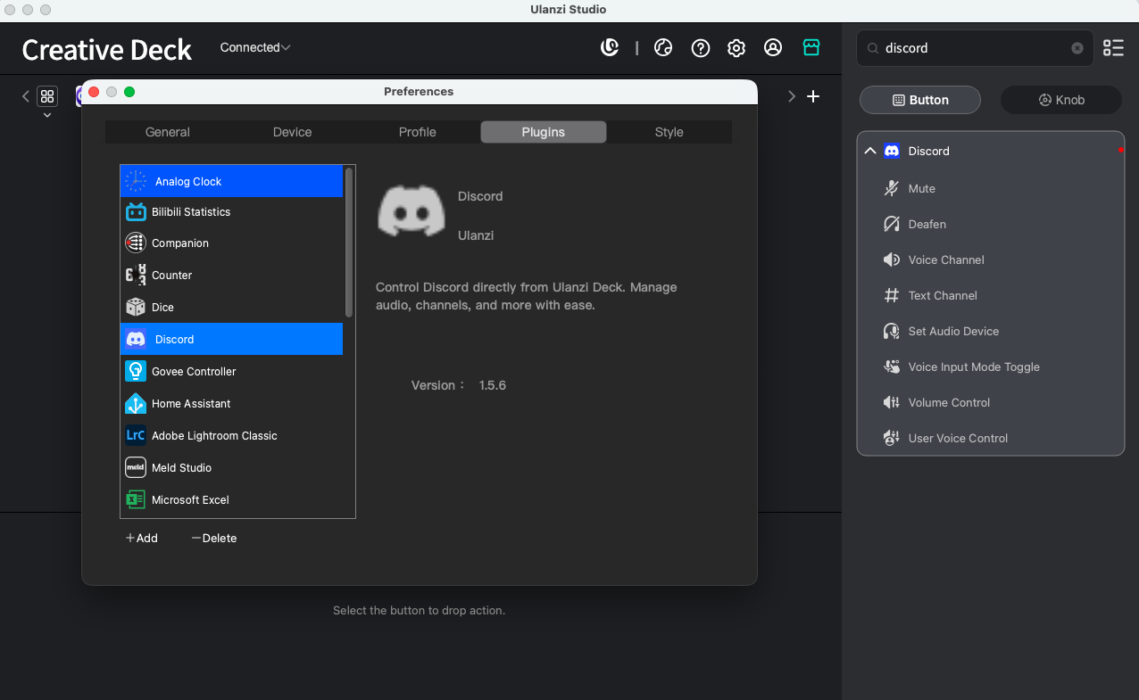

1. 启动您电脑上的 Ulanzi Studio 软件,点击顶部导航栏的 “应用商店 (Marketplace)”。
2. 在搜索框中输入 “Discord” 并回车,找到官方插件后点击 “安装”。
3. 安装完成后,返回主编辑界面。从右侧的“动作列表”中,将任意一个 Discord 动作(例如 "Toggle Mute")拖拽到您想设置的实体按键上。
4. 此时,软件右侧的属性检查器会自动弹出配置窗口。点击 “添加新的 Discord 账户” 按钮。

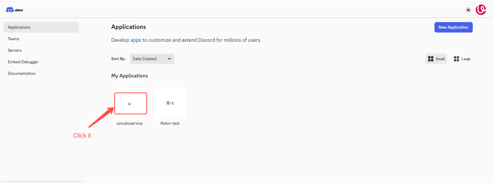

If you encounter no response when clicking the link button during plugin installation, please troubleshoot as follows:
1,Please ensure the Discord plugin is updated to the latest version and keep the Discord app running. If not, you can delete it in the Settings and download the new version from the Marketplace again.
2,According to the instruction guide (pictured), https://www.ulanzistudio.com/doc/discord_en, set up the Redirects is accurate, check each note.
3. The Discord API has request limits. After clicking the connect button once, please wait approximately 10 seconds. It should connect automatically under regular conditions. Avoid clicking repeatedly within a short timeframe, as exceeding three clicks will trigger request restrictions.
If there is no response, please wait patiently for about 5 minutes. Restart both the Discord app and the Ulanzi Studio app, then try again. If it still does not respond, restarting your computer is necessary to restore normal connectivity.

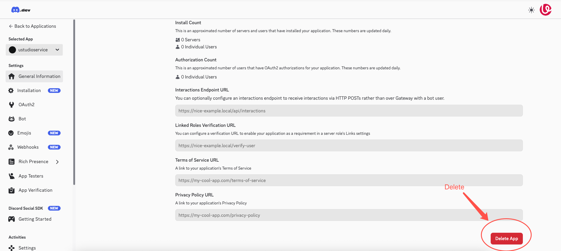

4,There is a possibility, if there are changes to Discord API, can be in https://discord.com/developers/applications, delete the old applications, to create a new application, When creating a new  application, please exit the Discord client. After creation is complete, restart the Discord client, then launch the Ulanzi Studio app.Finally, obtain the new ID and key, and enter them into the plugin to retry.
(If you encounter a situation where the authorization pop-up keeps reappearing when you click the link to authorize, please follow these steps as well.)
5,Account Troubleshooting:
Log in with a different Discord account, using a newly generated ID and token. In the Ulanzi Studio app, uninstall the plugin, then reinstall it and enter the new ID and token.
6,Network Restrictions:
If your computer supports Wi-Fi, try connecting to a mobile hotspot from your phone. Switch to a different service provider to see if the connection works normally. (This is just one possible cause to investigate.)
