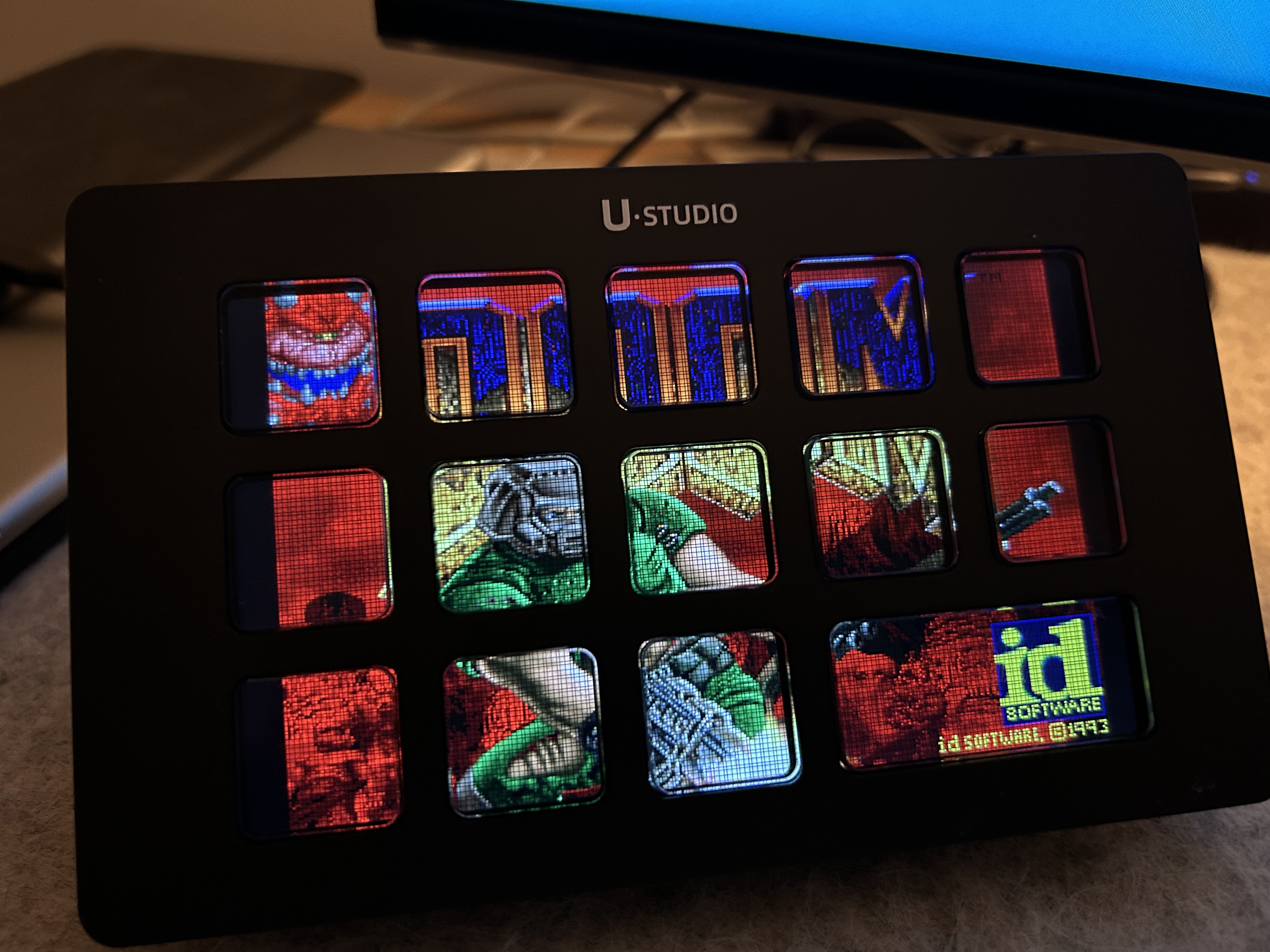

The device can send nativ key commands because it is registered as a HID. This works completely without any control software if you have a shell access on the device:
  1. #!/bin/sh
  2. HID="/dev/hidg1"
  3. echo "Send Key 'x'..."
  4. echo -ne '\x00\xE9' > "$HID"
  5. sleep 0.1
  6. echo -ne '\x00\x00' > "$HID"
152

how did you make this device run bash script?

There is a vulnerability. I'm root on the device. I wrote 2 mails in 1 week to ULANZI but no reaction ...But the big question is: will it run DOOM?
Yessss!

if not, can you share how did you get the bash script hacked into the system? i'd like to customised the device a little bit
thanks!

At the moment my answer is: no
There are some really bad comments about my findings here: Reddit
Maybe ULANZI is contacting me here in the forum or by mail but there is still enougt time for them until potentially disclosure by me.

just read the post.
I'll try have a look on the unauthenticated path myself
but i agree that how the auth data the software handled is really bad, just plain text stored locally
